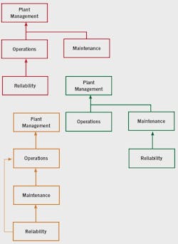

This design enables the reliability department to focus on engineering things properly so as not to be pushed by operations to resume too quickly or to be pulled by maintenance to work longer on the repair. Some of the more common organizational designs are shown in Figure 3, but these are sub-optimal because reliability personnel do what their bosses want, and this normally involves daily maintenance and operations, not the long-term issues of improving systems and processes to improve overall plant reliability.
Figure 3. The reliability department typically reports to or through the operations or maintenance department, though these are not optimal arrangements.
