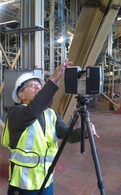

Figure 1. Scanners are line-of-sight devices, so they must be repositioned a few times to capture dimensions blocked by solid objects. Integrating laser scanning into the workflow has allowed collection of as-is conditions in undocumented facilities.
At Construction Management and Design Services (CMDS), we’re based in Cypress, California, and we specialize in design and project/construction for food and beverage facilities, utilizing 3D laser scanning technology. By integrating laser scanning into the workflow, we’ve been able to collect as-is conditions of undocumented facilities (Figure 1).
Prior to implementation of laser scanning technology into our workflows, we used a combination of tape measures, laser levels, transits, levels, plumb bobs, and laser range finders to collect measurement data of structures varying in size from 1,000 to 100,000 sq ft. In addition to being a time-consuming and tedious process, these methods exposed projects to delays in scheduling and financial risks due to potential inaccuracies in the data.

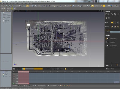

The laser scanner’s comprehensive data collection eliminates the need for return trips to a plant for additional measurements, and the data collected provides a permanent record that can be used many times over in future design projects. For example, we often use the point cloud data collected using the Faro Laser Scanner in facility management projects to show the exact location of various machinery (Figure 2). The data helps clients to quickly identify component failures, while minimizing plant downtime (Figure 3).
Figure 2. Point cloud data can be used in facility management projects to show the exact location of various machinery.
Figure 3. Data helps to quickly identify component failures, while minimizing plant downtime.
In a recent project at a beverage manufacturing plant, we were tasked with relocating a 24 oz can filler and packaging line to another plant. The floor plan of the original location of the 24 oz can line was completely different than the proposed location, where a 12 oz bottle filler and packaging line needed to be removed prior to the new system’s installation. Scanning both the bottle and can line facilities, the design team was able to determine which parts of the existing system could be used in the new design and how to fit the 24 oz packaging components in the new location.
