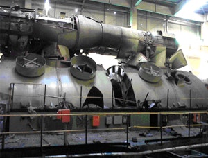

Figure 2. A 600 MW turbine generator set literally came apart in South Africa because the mechanical overspeed bolt failed to deploy during an overspeed test. Calibration of this mechanical bolt is a complex procedure, and it can’t be tested without going to an overspeed condition.
Several things can add to the complexity of a maintenance plan or procedure. High-speed machinery is much less forgiving of misalignment than the typical 1,200 or 900 rpm pump, blower, or fan. A 600 MW turbine generator set literally came apart on February 9, 2011, in Johannesburg, South Africa, because the mechanical overspeed bolt failed to deploy during an overspeed test. (Figure 2). Calibration of this mechanical bolt is a complex procedure, and the problem is that you cannot actually test it without going to an overspeed condition. That is why at JEA’s Northside Generating Station we pursued and obtained approval from our insurance carrier to conduct electronic overspeed tests in lieu of the mechanical overspeed testing. Both cases call for a high degree of precision in the execution of the work, so this needs to be emphasized in the plan or procedure.
