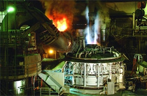

Georgsmarienhütte’s production process starts in the melt shop where the scrap metal is processed in the electric arc furnace. The molten steel is then transported to the oxy-fuel burner. The second production step includes two ladle furnaces, a vacuum degasser, and a conditioning and trimming station. The liquid steel then is shed in one of two areas, depending on the customer order.
