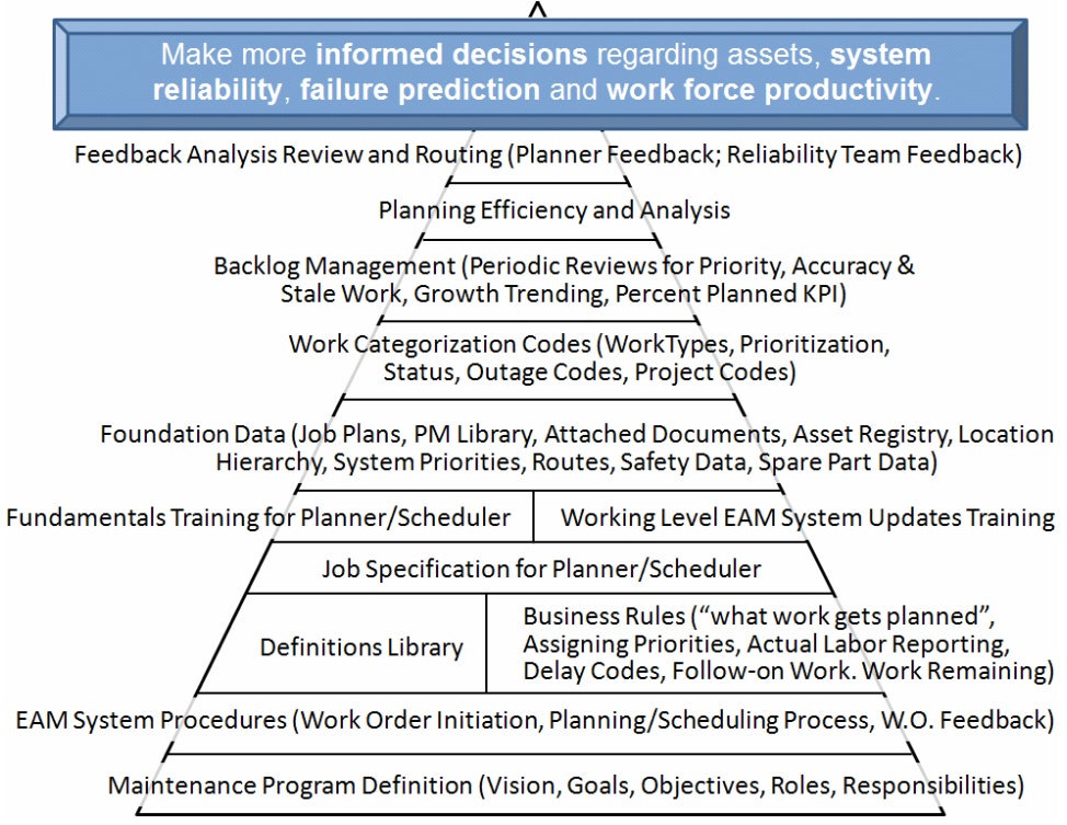

Everyone seems to talk about the importance of work planning within the enterprise asset management (EAM) system. Vendors often discuss how the software supports workforce management, work categorization, and job planning. And EAM users frequently participate in user forums, attend training classes, and talk with other peer groups in an attempt to improve work order planning. If all of this is true, why are so many sites still struggling to fully implement maintenance planning?
Although some industries have the work management planning process finely tuned, others are stuck in a self-imposed, reactive maintenance mode and are unsure how to escape. Just because they have planners doesn't mean they are fully engaged in (or supportive of) future work planning. Rather they may be actively involved in reactive maintenance support.
A proactive maintenance planner actively supports future work scheduling and reliability centered maintenance. Job Planners often assist with identification of recurring problems, faulty parts, and work order feedback. Plus, they participate in maintenance backlogs, work priority validation, job plan creation and PM library reviews.
The lack of proactive planning is illustrated in Figure 1 where Process A handles all work the same and Process B allows for proactive maintenance (Figure 1).
This means we need to start identifying work that can be planned and begin making weekly schedules. But it’s not that simple.
There can be many reasons why the planning process is not working. And it only takes one reason to cause a real problem. When it comes to work order planning, you might encounter the following:

Foundation data and process
The maintenance program needs to clearly define the role of the maintenance planner. This skill set can add efficiency to the maintenance organization and is absolutely critical to reducing reactive maintenance. In order to make more informed decisions within the EAM system, it’s important to have all of the supporting elements (Figure 2).
