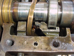

Figure 1: Many oil rings tend to misalign and then touch portions of the housing interior. As abrasion occurs, the lubricant will be contaminated.
A case in point would be API Ninth Edition (January 2003) Paragraph 3.33, which doesn’t list oil rings (Figure 1) among the wear parts to be replaced during pump overhauls. Of course, the API standard also doesn’t mention when, where, or why oil rings are not the preferred lube application method for reliability-focused users. The standard thus leaves the choice to the pump manufacturer, and low manufacturing cost becomes the driver.
Experience shows, however, that unless a shaft system is installed perfectly horizontal, oil rings run downhill and often make intermittent contact with a stationary interior part of the bearing housing. They then slow down and become unstable. Worse yet, they now tend to abrade, and you can see loss of chamfer after a few months of operation. The wear product contaminates the lube oil, which causes bearings to fail very rapidly. The lube oil often turns gray in color, which is a sign that oil ring debris is present.
While aligning shafts, we usually put shims under part of the pump or its driver. Rarely do we ensure shaft system horizontality. Also, oil rings become unstable at certain shaft surface velocities. And this causes reliability-focused users to question the applicability of oil rings in modern pumps. Oil rings are immersion-sensitive — that is, more oil, more drag. They are viscosity-sensitive, meaning thicker oil results in more drag. They are also extremely sensitive to both out-of-roundness and rough RMS surface finish. They will become out-of-round unless they are first rough-machined, then stress-relief-annealed and, finally, finish-machined.
Combine all of the typical field deviations and you'll probably end up with a “safe” DN-limit (inches of shaft diameter times rpm) of somewhere around 6,000. That's an experience-based limit; it was also used in a multinational oil company’s lube marketing-internal training courses. Invoking this safe limit will perhaps allow a certain amount of deviation from perfect shaft horizontality, ideal ring depth of immersion, oil viscosity, ring concentricity, and ring I.D. surface finish (recommended to be 32 RMS). Unfortunately, nobody knows the extent to which every possible deviation from ideal values occurs in operating equipment or which combination of deviations will bring on oil ring instability.
