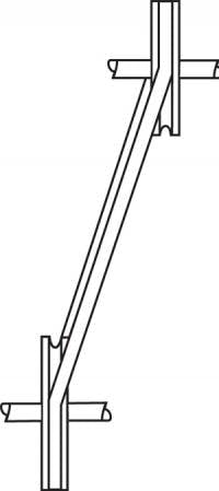

When installing belt drives, it is important to tighten the sheave bushing to the proper torque. Doing so ensures that the sheaves are located properly. Proper installation and location of belt drives can have impact on unit life as well as unit efficiency.
[pullquote]
Proper installation of the sheave and bushing is a relatively simple process, and most experienced maintenance staff can perform the task easily. There are, however, a couple of key points that need to be made. First, lubricant should never, never be used with bushings. Lubricating the bushing may seem like it will allow the fasteners to tighten more easily. It will, but too much. Lubricating the fasteners will multiply the torque applied and commonly will exceed the strength of the bushing, causing the bushing to crack. That crack and the resulting loss of clamping force on the shaft may not be apparent until a system comes up to speed. At that point, the looseness of the bushing may result in sheaves moving, belt damage, and other undesirable results.
Installing and tightening the bushing for a belt drive is key to capturing the full performance of the belts and achieving full belt drive life.
Figure 1. Improperly torqued bushings can cause sheave misalignment.
If the bushings are not torqued properly, it is likely that the sheave will be out of position (Figure 1).
Having belts out of alignment will mean that they will transmit torque inefficiently and, therefore, cause the motor to work harder to achieve the application requirement. Put simply, it costs more energy to run misaligned belts.
In addition to running inefficiently, belts that are misaligned will wear faster on one side of the belt and groove, resulting in lower belt life and worn sheaves. Again, it costs more to run misaligned belts.
Using a torque wrench and following manufacturer’s guidelines for tightness will assist in ensuring that bushings, sheaves, and belts are aligned to the manufacturer’s specifications and that the system will achieve the desired levels of performance and life.

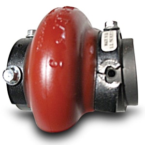

When considering couplings, applying the proper level of torque is both good practice to ensure couplings stay in position and also good safety practice. Like open gears, set collars, clutches, and similar devices, couplings are subjected to a range of vibration and shock as a matter of machine operation. Properly tightening hubs onto the shafts ensures that couplings stay in position. A loose coupling hub under vibration can easily contribute to key and keyway wear that can mean significant re-work in the future. Consider a shaft with a damaged keyway and the expense of replacing it simply because the coupling hub was loose.
Figure 2. This coupling hub was over-tightened by the installer to the point that the sleeve cracked on the hub. Over time this sleeve will move and could become loose.
For some couplings, proper tightness is a matter of safety. Consider gear, grid, or similar couplings that have a cover that encloses the coupling elements. The fasteners that hold the cover in place must be tightened to the proper torque specification to ensure the fastener is seated properly and will stay in place under rotation and vibration. Consider the consequence of that cover becoming loose and becoming a projectile. It doesn’t take a stretch of the imagination to see how a coupling cover that breaks free of a 1,750 rpm shaft can easily become a life-threatening event.
Elastomeric couplings also must be tightened properly to be installed properly (Figure 2). Some couplings have fasteners that are designed to ensure they stay in position and hold the sleeve firmly to the hub. Ridges on the fasteners can engage the sleeve material and lock in place, but only if they’re torqued to the proper tightness. Failing to torque the bolts correctly can mean the sleeve will be loose and could become a danger to those working around the machines.
