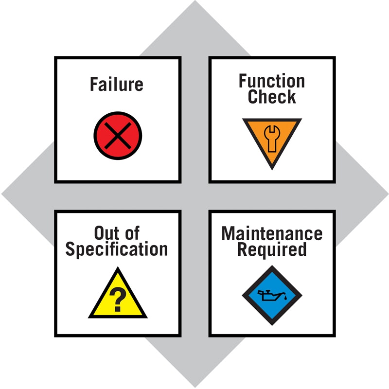

The role of the operator has become more complex (Figure 1). An operator needs to look at information from a wide array of systems, not just the distributed control system. Information comes from plant asset management systems, electrical reliability systems and other sources. There also are fewer personnel in many of today’s process plants, so the operator’s job has widened in terms of the scope of the plant. NE 107 categorizes internal diagnostics into four standard status signals — failure, function check, out of specification and maintenance required (Figure 2). Each of these categories can also contain greater detail. In the case of failure, for example, is the failure related to the device or the process? Is maintenance required immediately, or is the requirement more for long term maintenance?

The Fieldbus Foundation accomplished the integration of the recommended diagnostic alert conventions— failure, function check, out of specification and maintenance required — by mapping the diagnostic information available from supplier Foundation Fieldbus devices through the device library portion of the fieldbus system. Now, any Foundation Fieldbus end user can take advantage of the diagnostics harmonization capabilities of NE 107 in the fieldbus system.
The ultimate result of this is a series of new field diagnostic alarms that correspond to the five primary diagnostic categories outlined by NAMUR in its document. Several additional supporting parameters are also available now, including enable/disable of diagnostic detection, configuration of priorities and configuration of alert suppression. With NAMUR NE 107 diagnostics built in, you can turn off diagnostics you don’t need or configure how the diagnostics are reported. This supports the configurability mandate of NE 107. Providing recommended actions and enabling simulation allows the information to be presented in greater context.
