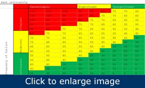

A cross-functional team composed of employees from operations, maintenance, engineering, materials management and safety conducts the first phase of a criticality analysis. The analysis looks at how equipment failure would affect customer orders, time to production disruption, employee safety, environment, the ability to isolate the failed equipment, equipment history of mean time between failures (MTBF), PM/PdM history and the overall predictability of failure. Each of these factors receives a weighted score between zero and 100 that converts into a criticality ranking as shown in Table 1.
Divide the scores into categories that rank failure severity as catastrophic, significant or insignificant. A rating of “catastrophic” indicates a part or assembly is an item that must be held in inventory; it’s a critical part for a critical asset, and it has been identified as a safety compliance issue if it fails. A rating of “significant” indicates the part is for a non-critical asset and probably would fall into the category of a normal MRO consumable item. The “insignificant” rating indicates the part was non-critical and not a safety concern if it failed.
Table 1. Factors receive a weighted score between zero and 100 that converts into a criticality ranking.
