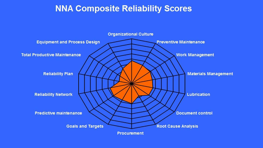

Figure 2. Spider charts, Pareto charts and color-coded element pyramids were used to showcase each element’s scoring.

Most of the scores went up during the review of the assessments. In fact, the majority of the plants were too hard on themselves, forgetting to take credit for the things they were doing well.
