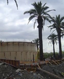

Figure 3. This shows the construction of the holding tank and anaerobic digester for the new biogas-powered cogeneration facility.
An anaerobic digester (Figure 3) treats beer waste to produce biogas that fuels the cogeneration plant and produces electricity for the facility. The thermal energy the cogeneration plant produced heated the digester to offset high-quality steam/hot water for use in various beer manufacturing processes. EPS completed the biogas cogeneration project on schedule and within budget.
The biogas-powered cogeneration plant provides 1 MW of power that reduces MillerCoors’ electric utility bill and reduces the brewery’s carbon footprint by providing the necessary power at a lower emissions rate. Excess gas was used for additional power generation capacity. In addition, it helps the brewery reduce waste by using recycled byproducts as fuel.
