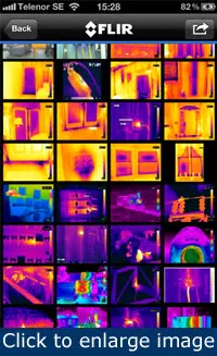

Figure 1. The FLIR Viewer App lets you send thermal images directly to your iPad and email it right away.

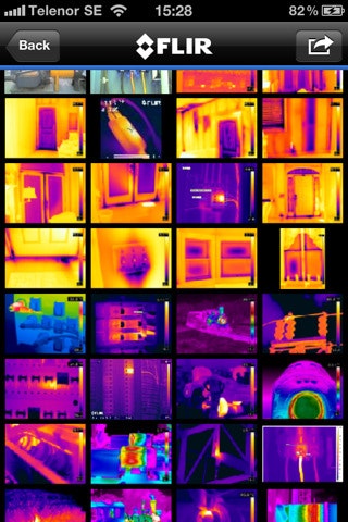

Figure 2. With an iPhone, you can carry every FLIR IR picture ever taken anywhere you go.
The Flir Viewer App, released earlier this year, lets you send thermal images and data from a Flir E-Series or T-Series camera directly to your iPhone, iPad or iPod touch without connecting cables or swapping SD cards. “With this app, when you snap a picture of a problem with your Flir camera, you can call it up on your iPhone via Wi-Fi from the floor and email it to any number of recipients right away,” says Ed Kochanek, director of sales, eastern region, for Flir Systems (www.flir.com). “The app (Figure 1) is generating great excitement with our customers. With an iPhone or iPad, it’s easier to store, scroll through, analyze and share pictures. It allows you to carry every picture ever taken anywhere you go (Figure 2).”

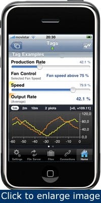

The ProSoft i-View, launched in 2010, is a mobile app for Apple devices that enables remote process monitoring and control with real-time process data. “If you need to know immediately when there’s a fault in a line valve, or a motor seizes, or a drive stops working, the i-View can detect it,” says Chris Hines, training manager for ProSoft Technology (www.prosoft-technology.com). “We recognized the inevitability of melding between consumer and industrial technologies via mobile apps. So, we began investigating opportunities to leverage these tools to complement our solutions and our customers’ applications.”

Figure 6. ProSoft i-View enables real-time remote process monitoring from your iPhone.
First and foremost, mobility drives visibility. “You don’t have to be sitting at a computer to see the data,” says ProSoft’s Hines. “With Wi-Fi, you can be anywhere in the plant. With a cellular network, you can be anywhere in the world. It gives executive management a view into the process, as well” (Figure 6)
