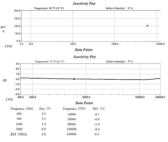

Question 8: Should you use a precision or low-cost sensor?
There are two main differences between low-cost and precision accelerometers. First, precision units typically receive a full calibration, that is, the sensitivity response is plotted with respect to the usable frequency range. Low-cost accelerometers receive a single-point calibration and the sensitivity is shown only at a single frequency. Second, precision accelerometers have tighter tolerances on some specifications such as sensitivity and frequency range.
For example, a precision accelerometer might have a nominal sensitivity of 100 mV/g ± 5% (95 mV/g to 105 mV/g) (Figure 2) while a low-cost accelerometer might have a sensitivity of 100 mV/g ± 10% (90 mV/g to 110 mV/g). Customers with data acquisition systems often will normalize the inputs with respect to the calibrated sensitivity. This allows a group of low-cost sensors to provide accurate, repeatable data. Regarding frequency, a precision accelerometer typically has frequency ranges in which the maximum deviation is 5% while low-cost sensors might offer a 3 dB frequency band. Even so, a low-cost sensor might offer excellent frequency response.
Comparison of calibration data for a low cost (top) and precision (bottom) accelerometer.
Figure 2. The upper plot corresponds to a low-cost accelerometer that was calibrated at one point, while the lower plot, with its continuous calibration line, corresponds to a higher-cost unit.
