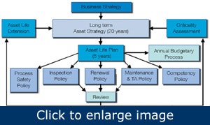

What does the integrity management system actually consist of and what does it look like? Figure 1 shows how an integrity management system can be developed.
The system hinges on a coherent asset strategy that defines the requirements to be placed on the assets to support the business strategy. The asset strategy is implemented by a range of policies covering process safety, maintenance and inspection, renewal and competence. The main aspects of this strategy include the development of these policies.
  • A process safety policy covering the identification of major hazards and measures to eliminate, reduce and mitigate those hazards. This would include a documented design basis for the process, identification of residual risks and definition of risk-reduction measures. It should also define safe operating limits for equipment and how operations are controlled within those limits. The policy should also define how to deal with excursions outside the limits, where equipment integrity may be affected.
  • A maintenance policy, which should set out how safety, health, environmental risks and the risks to production are to be monitored and controlled by engineering maintenance activities. This includes defining the optimum balance between on-stream and off-line maintenance, and how preventive maintenance is complemented by turnarounds and overhauls to ensure continued fitness for purpose and integrity for operation. It should also cover the policy for critical spares.
  • The inspection policy should address the what (what is to be inspected, types of equipment, specific areas of the equipment), how (how it is to be inspected, on-line vs. off-line, invasive vs. non-invasive techniques) and when. Gathering of data during inspections and storage of that data in a history file is key to addressing the issues of aging and the ability for continued service into the future
  • The renewal policy would address the question of when does the equipment come to the end of its life. The key to this question is not about how old the equipment is, but about knowing what condition that equipment is in at the present time and how the condition changes over its operating life. In many cases, the decision to extend the life of equipment is as much an economic and practical decision as it is a technical one. How well are the life-limiting deterioration mechanisms known? What is the impact of equipment obsolescence? Which factors trigger the decision to carry out significant repairs and replacements? This is a particularly pertinent issue for most large-scale process plants, as much effort has been undertaken in recent years to reduce the duration of and extend the period between major planned shutdowns. By using such techniques as RBI and RCM, operations have focused maintenance and inspection activities on minimizing the need for maintenance and inspection work, so maximizing production cycles.
  • The competence policy declares how the core competence of the organization is to be maintained: what are the knowledge, skills and experience required for the key personnel, and how that is to be developed to ensure effective organizational competence. It should also cover the competence and availability requirements of external resources, and how their role in maintaining integrity is communicated and assured. The policy should describe how learning from incidents and feedback from audits is used to strengthen integrity management processes.
Each area needs to be robust, supported by procedures, practices and standards. It is further supported by competent resources, effective communication between groups, auditing and management reporting.
