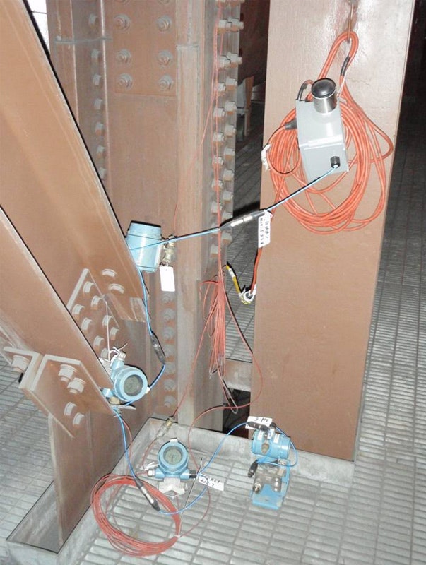

The group maintains 240 transmitters, mainly for temperature and pressure, and some flow devices. These have traditionally been hardwired to HART multiplexers to accommodate cable runs across facilities, even over streets, to conduct tests. Setting up a test run occupied significant time and labor.
Conducting a test entails more than the test itself. Any test could entail days for setup and another for teardown. Hardwired network multiplexers were well-worn and, in some cases, failing because of wear and tear. Likewise, the profusion of wiring risked damage as cables were used and reused from one site to the next connecting at times more than 100 far-flung sensing and transmitting instruments across a facility and crossing not just the plant, but also roadways.

The prototype Bullet, introduced in 2009, could support six HART transmitters in field-proven HART multidrop mode. It has since expanded to eight, which is what the Performance Testing Group now uses. For either iteration, Fletcher explains this capability meant a wireless gateway could replace the failing multiplexers, and far fewer cables would need to be deployed for temporary test transmitter installations. “The economics of a hybrid wireless-wired HART system became more feasible for us to consider,” he says.
The Performance Testing Group’s wireless solution uses pre-existing Rosemount Smart HART transmitters and some key pieces of new equipment:

The resulting system uses the Bullets to communicate HART data, including the process variables, through the Emerson gateway, into a laptop PC, where data are imported to an Excel spreadsheet using Matricon Analytics’ plug-in Excel Reporter, an OPC plug-in.
MACTek’s Bullet is designed to provide access to real-time information from installed intelligent HART-enabled field devices. It is available in general purpose as well as in certified intrinsic safety and explosion-proof models. The Bullet recognizes each HART-compliant device and sends that information back, with the instrument’s tag name, so the team’s data acquisition can import field data.

However, in actual use, it turned out that the Bullets don’t necessarily need be in line-of-sight to establish a network. He also notes that a WirelessHART network can take 10 or 20 minutes to get fully established with all HART subdevices reporting, “but the radio links will form in circumstances that Wi-Fi couldn’t hope to achieve, and they just work,” says Fletcher. “Wi-Fi was designed for speed, while WirelessHART was designed for data reliability.”
