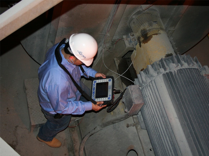

Figure 2. When a machine analyst collects vibration data from a forced draft fan at a 49 MW municipal waste combustion power generation plant in Haverhill, Massachusetts, it might be more cost-effective for that to be part of an outsourced machine condition monitoring program.
