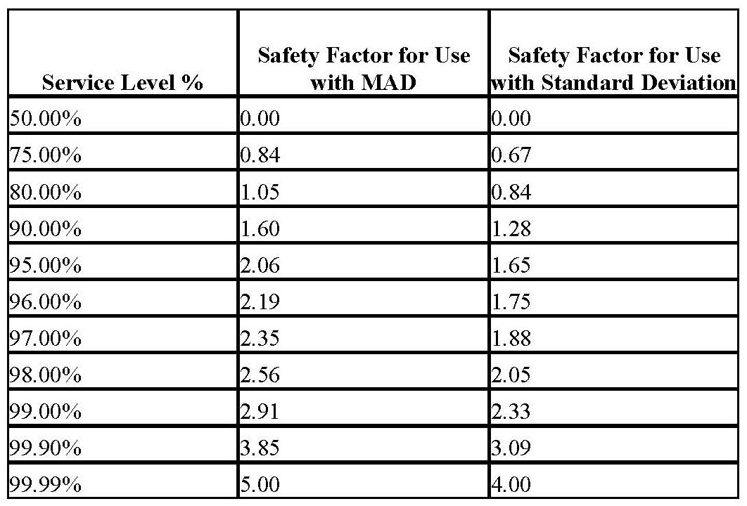

3.  Assign service-level expectations by material classification. Critical materials might require 99% fill rate. Non-critical materials might be set to 90% fill rate. You could use a 75% fill rate for easily acquired materials such as those items that might be purchased in local retail establishments when you fall short of requirements.
4.  Choose the statistical equivalent for calculating safety stock based on approved service level (Table 3).
Table 3. Service level
5.  Calculate the safety stock levels for each inventory item. Record the quantity issued in each of the past 52 weeks and calculate the average weekly usage based on these 52 weeks. Record each week’s absolute deviation from the weekly average and then square those values. Add the squared absolute deviations and calculate the average of the total squared absolute deviations. Next, calculate the square root of the average of the total squared absolute deviations. Using the mean absolute deviation (MAD) safety factor from Table 3, multiply the relevant safety factor for each material by the calculated square root of the average total absolute deviations. This is your safety stock quantity, which might need to be rounded upward to match inventory unit of measure (Table 4).
Table 4. MAD Example
Service levels
Service level is a measure, usually expressed as a percentage, of satisfying demand through inventory, when requested. For example, if we want to be certain that four out of five times an item will be in inventory when required, then we would require at least an 80% service level (4/5 = 0.8). The service factor is a statistical measure (safety factor) associated with the percentage service level and used to calculate the safety stock for each item. For optimization, we use MAD, the sum of absolute deviations from calculating weekly usage — average weekly usage and then dividing that total by the number of observations.
The normal distribution curve is described by two characteristics. One relates to its central tendency, or average (the 0 line), and the other to the variance, or dispersion, of the actual values above and below the average.
The safety factor is the numerical value based on the forecasted standard deviation or MAD to provide a given level of customer service. For example, if the item’s MAD is 100 and a 95% customer service level (safety factor 2.06 from Table 3) is desired, then a safety stock of 206 units (100 X 2.06) should be carried as safety stock.
Because MAD is always smaller than standard deviation, by about 1.25 times, the multiple of the safety factor with MAD must be greater to be equivalent. The table of safety factors already reflects this adjustment.
