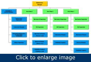

By taking best practices and placing them into an organization chart, you could end up with a sample as shown below. Although there are several acceptable alternatives, this is one example of a flat organization, with centralized and decentralized elements and dotted/solid-line reporting relationships.
