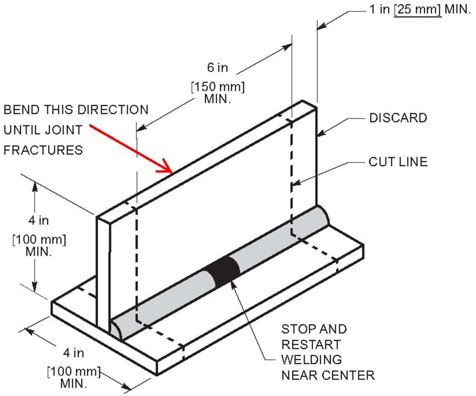

Figure 2. The welder makes a weld in the location shown. The portions designated as “discard” are saw-cut off, and the remaining portion is bent so that the root of the weld is put in tension. If the plate bends on itself, the weld is good; if the weld fractures, the fracture surface is examined for excessive defects (based on AWS B2.1:2000, Figure 3.8, reproduced with permission of the American Welding Society (AWS), Miami).
For a welder of unknown skill, or if the materials represent a new experience, the welder can demonstrate skill at minimal cost to you by fillet welding together two plates of a material similar to that to be repaired, to form a “T” as shown in Figure 2. This T can be bent and the resulting fracture evaluated. The test piece should be welded in whatever position the welder must work to make the repair.
