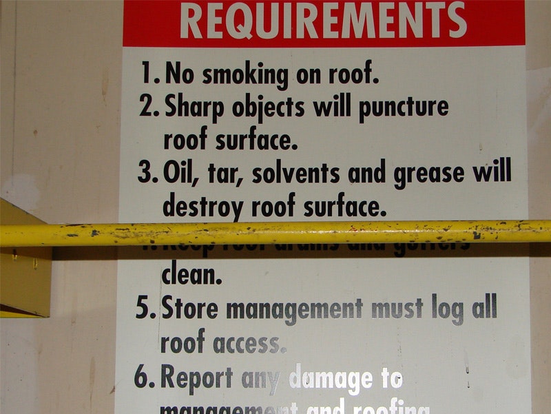

Figure 2. Establish and post rules to avoid initiating roof problems inadvertently.
Roofs with lots of foot traffic can use lightweight pavers or integrated foam-and-concrete systems. These pavers typically weigh 10 lbs/sq.ft. to 12 lbs/sq.ft. and the integrated systems weigh 4.5 lbs/sq. ft. Finally, there are membrane systems with pavers or walk pads leading to units that will need servicing.
Regardless of the roof system, it’s good to control and record roof access (Figure 2).
