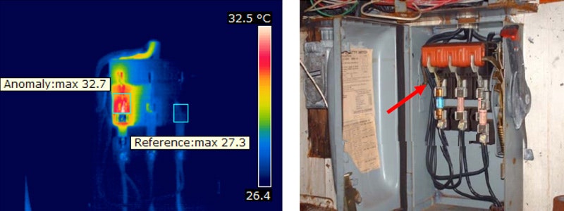

Motor circuit test The second test was conducted in one of our customer plants. We collected data from the fuse box for a 480-VAC, three-phase motor circuit (Figure 3), which had a bad connection on one of the fuses. The intent was to check the loss calculations for a thermal anomaly with a greater load current and junction surface area than we used in the bench test. In addition, we wanted to check the thermal model under conditions where there is a small difference between the junction and background temperatures. In the bench test there was about a 25°C difference; in this test the difference was about a 5°C.
Figure 3. Thermogram/photo pair of a test conducted on a faulty fuse connection in a 480-VAC, three-phase motor circuit.
Using the IR thermal loss model, we calculated 0.2 W of power lost at the loose connection. The voltage drop across the junction was 0.102 V, and a current through the circuit was 24.9 amps. Using Ohm’s Law, we get 2.53 W of power dissipation. This was even more disappointing that the results of the bench test.

A poor estimate of the junction surface area above the fuse in question probably accounts for some of this and is exacerbated by the small ΔT. There also might be a problem is using a unity view factor, F, to calculate the radiative loss. (Sidebar 1) In addition, we might have used the wrong emissivity value, and using a reference temperature based on one of the other fuses might not have been the best comparison. We probably should have used the lower background temperature. These factors notwithstanding, the conclusions we drew from this test were basically the same as those from the bench test.
