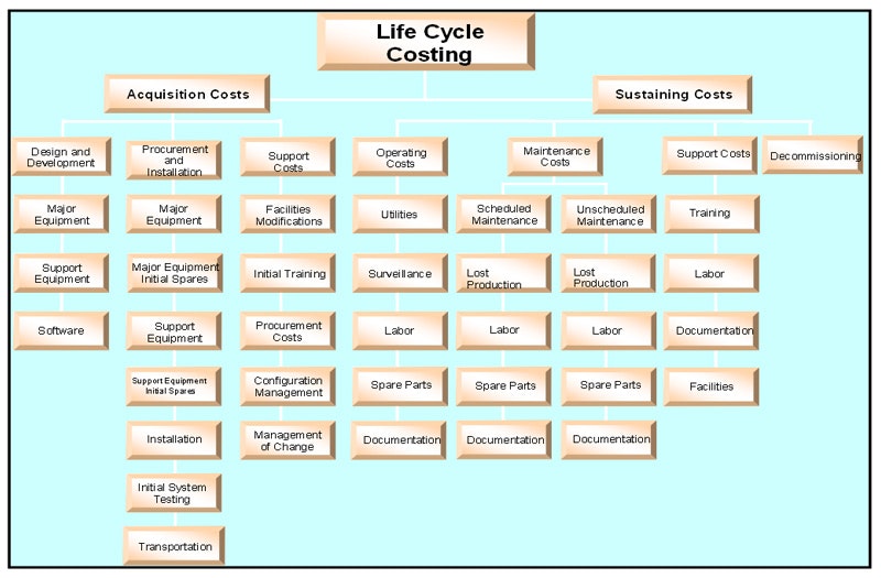

Figure 2. This represents more detailed life-cycle cost considerations.
The three predominate life-cycle cost design strategies are the minimum initial cost (IC) design, the minimum running cost (RC) design and the combination IC/RC reduction design (optimum cost). Regardless of strategy chosen, all acquisition and sustaining costs must be considered (Figure 2).
