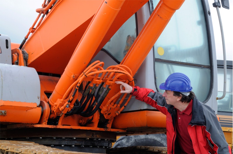

Maintenance personnel and on-site service technicians should perform visual inspections regularly (Figure 2). Nevertheless, operators of machinery or equipment also should inspect hydraulic hose because a failure affects the operator much more than maintenance personnel who won’t be at-hand when the hose fails.
Most mobile equipment operators are trained to inspect their vehicles before they turn the ignition key, like a pilot inspecting aircraft systems before a flight. This pre-usage checklist might include making sure fluids are topped off (oil, coolant, fuel, etc.), checking for physical signs of damage and inspecting critical operating components. It also should include a quick visual inspection of hydraulic hose assemblies, especially those in close proximity to the operator, because a failure could cause injury. A little training can go a long way (Figure 3).
Figure 3. Never use your bare hand to inspect a pressurized hose.
In a plant setting, machine operators should perform a visual inspection of any nearby hoses. Because these operators work with the machine daily, they’re more likely to notice if a hose exhibits the warning signs. Here, too, proactive hose replacement avoids personal injury.
