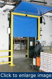

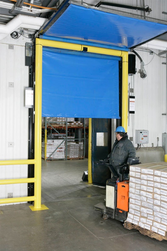

Figure 1. A transparent door panel is a boon to safety, but long-term visibility depends on preventing surface scratches on the panel.
More transparency is generally better with any high-speed door (Figure 1). But, also realize that the panels can be scratched or scuffed over time, which can impair visibility. Look for fabric door configurations designed to extend the life of vision panels. In situations where vision panels don’t always work, such as cold storage environment, consider sensor and light communication packages that alert forklift drivers to people and objects moving on the opposite side of the door.
