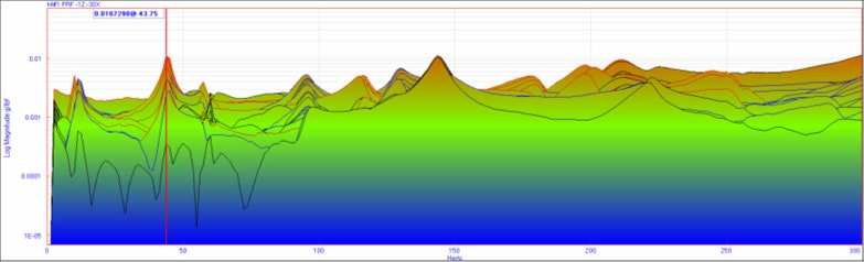

Figure 2. Shop modal test overlay of 435 FRFs 300 Hz frequency span) showed several structural modes in the operating speed range.

After establishing driving (reference) points, a force hammer and tri-axial accelerometer captured single input, multiple output (SIMO) data to generate frequency response functions (FRFs) at the selected DOFs. The FRF is a complex ratio of the output and input signal as a function of frequency; measured in g’s/lbf for impact testing.

The control test revealed several significant structural modes in the operating speed range (Figure 2). These included an 11-Hz frame cantilever rocking mode, a pronounced 43-Hz torsional mode around the vertical axis and several combined bending/torsional modes at higher frequencies.
Figure 3 shows the 43-Hz torsional mode front-view. From above, the swing-arm pivoted around the vertical (Z) axis very near the center of the frame, with significant lateral movement at the spindle bearing. This mode would increase the likelihood of contact between the spindle and its bushing. The contact contributed to the known failure mode characterized by surface galling defects from frame bushing contact that caused spindle failure.
Additional tests were then performed with soft-foot and hold-down bolt torque variations to gain better understanding of how mounting variations affected the structural responses. Overall, we noted that the mode shapes and frequencies changed somewhat, but that the fundamental bending and torsional frame modes remained.
