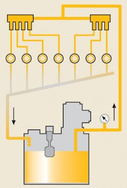

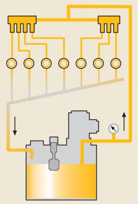

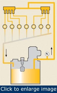

Figure 2. Circulating systems offer the opportunity to remove wear particles and contaminants.

In circulating-oil lubrication systems (Figure 2), the lubricant flows back to a reservoir for reuse after passing through the friction points. In this way, the lubricant, without human intervention, removes abrasion particles from friction points, stabilizes the friction point temperature (cooling or heating), prevents corrosion, and removes condensate and process water.

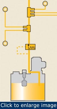

Figure 3. A single-line, total-loss system operates only as required to replenish consumed lubricant.
With either approach, installation configurations include single-line parallel, dual-line and single-line series progressive feeder systems. Single-line parallel lubrication systems supply relatively small amounts of lubricant (oil or eliminated fluid grease up to NLGI grade 2) to cover precisely the amount consumed. As such, they operate intermittently as required.
The standard layout of a single-line, total-loss lubrication system (Figure 3) has a pump and a positive-displacement metering device, often described as an injector piston distributor; main line (connecting to the pump and distributor); pressure switch for main line monitoring; and secondary line (connecting to the distributor and lube point). It functions as a total-loss lubrication system and has no oil return line from the lube point to the oil reservoir.
The piston distributors installed in the tubing system meter the lubricant by controlling the stroke of an internal piston. Exchangeable metering nipples on the distributors make it possible to supply every lube point with the requisite amount of lubricant per stroke or pump work cycle. Metered quantities range from 0.01 cc to 1.5 cc per lubrication pulse and lube point.

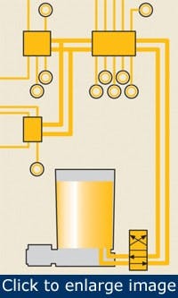

Dual-line systems deliver oil or grease (up to NLGI grade 2) to as many as 1,000 user-specified lube points (Figure 4). They can be configured to run either as total-loss or circulating-oil systems. Their layout consists of two main lines with their respective secondary lines and fittings, an electrically driven pump with reservoir, dual-line feeders, reversing valve, pressure switches for main line monitoring and a control unit.
Figure 4. Dual-line centralized systems can be configured to feed as many as 1,000 points in either recirculating or total-loss mode.
In a parallel system, the distributors are pressurized simultaneously, resulting in low pressure losses. The delivery piston resets itself under full pump pressure as opposed to the spring pressure used in a single-line parallel system. This makes the dual-line versions especially suitable for extended systems and more viscous grease. Assemblies with or without elastomeric seals can be specified to accommodate light and heavy-duty operating conditions.
