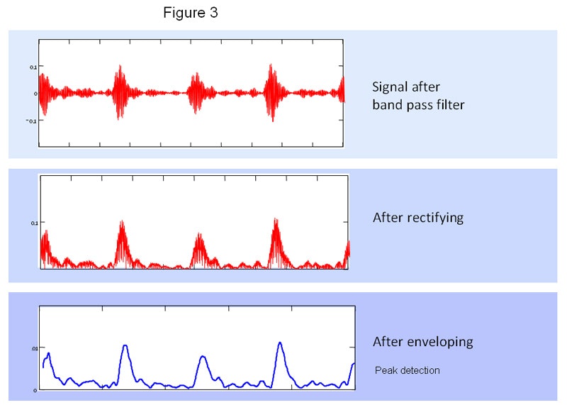

A shock pulse transducer contains a reference mass (m) and responds with a dampened oscillation when hit by a shock wave. Attached to the reference mass is a piezoelectric crystal which produces a voltage when compressed by the movement of the reference mass. This voltage is proportional to the amplitude of the oscillation and thus to the energy of the shock wave. The principle is the same as used in accelerometers for vibration measurement. There is, however, an important difference.
When a mass is excited at its resonance frequency, it will oscillate with much greater amplitude than at any other frequency. For vibration measurement, one normally stops measuring far below the resonance frequency of the transducer. On the other hand, shock pulse meters are mechanically and electrically tuned to operate exclusively at their resonance frequency of 32 kHz (fm), where the resulting signal is strongest. This gives us a very sensitive transducer for shocks only, but which will not react to "normal" machine vibration frequencies.

When a ball hits a damaged area in the raceway, it produces a shock wave. Shock waves are "transients" or short-lived waves starting with relatively high amplitude that quickly dampens out. In a time record displayed by an oscilloscope, these transients are often clearly seen, superimposed on the continuous wave produced by shaft rotation (see Figure 1). When the distance between transients is constant and corresponds to the ball pass frequency, this is clear evidence of bearing damage.
In the spectrum, however, peak amplitude is determined by the energy contents of the vibration at any given frequency. In relation to the energy at the shaft frequency, the energy of the shocks produced by the damaged bearing can be negligible. Thus, the ball pass frequency line has low amplitude and is easily lost among the”noise”, as shown in Figure 2. In the area around the resonance frequency, we can record a time signal, which clearly shows the transients produced by the damaged bearing. Each shock is a single event,
