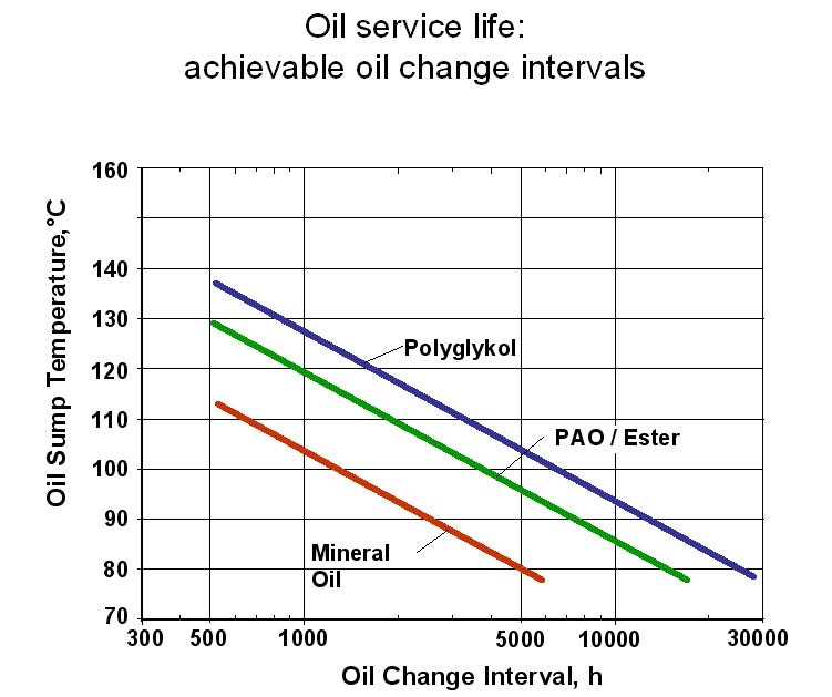

Figure 3. The prolonged service time of synthetic lubricants can reduce equipment downtime and resources.
Compared to mineral oil at an operating temperature of 175°F (80°C), oil change intervals with PAO could be extended up to three times, and with PAG it is possible to achieve five times the service life. As you can see, how often a manufacturer is required to change gear oil depends on the chemistry of the lubricant being used. The slope of the lines in Figure 3 represents the 10K rule: For every 18°F (10°K or C) you increase the temperature of the lubricant above about 180°F (80°C), you halve its performance life.
