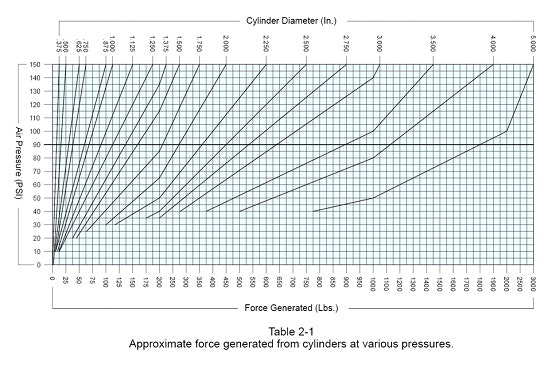

Figure 1. The approximate force a cylinder can exert is a function of inlet pressure and cylinder diameter.

If an individual application requires higher pressure for reasons other than point-of-use restrictions or improperly sized components, it might be best to reengineer the application instead of jacking up the operating pressure for the whole air system. It might be possible to use a cylinder with a larger diameter (see Figure 1), change lever or gear ratios, or install an air amplifier.
