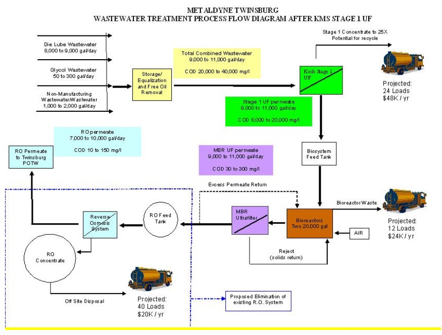

The plant’s drainage system collects the waste generated from the casting process, including the die lubricant, as well as detergents from washing operations and glycol from the hydraulic fluid used in the robotic machinery. In addition, some process cooling water and cooling tower bleed are piped into the wastewater treatment system. The total combined wastewater flow is 9,000 to 11,000 gpd, with chemical oxygen demand (COD) ranging from 20,000 to 40,000 mg/l.

In 1995, the plant installed a bioreactor system to consume the glycol. The membrane bioreactor (MBR) system was arranged with the tubular membranes external from the bioreactor, thus separating the water from the activated sludge. The effluent from the MBR was polished by a reverse osmosis (RO) system, prior to discharge into the municipal wastewater system.
Unfortunately, the tubular membranes in the MBR had difficulty handling the oils and greases, resulting in clogged pores in as little as three weeks. A scum, with a consistency of a foamy milkshake, formed on the top of the bioreactor tanks, often overflowing onto the floor. The die lube, which accounted for approximately 80% of the waste stream, seemed to be the source of the problem.

“A few years ago, we heard that a new tubular membrane was developed by Koch Membrane Systems that could handle extremely difficult oily wastewater, and indeed it proved effective,” says Cleary. “Finally, we had a system capable of removing the solids upstream of our bioreactor.”
In 2006, the Twinsburg plant installed a Konsolidator150 Industrial Wastewater System from Koch Membrane Systems Inc. (KMS) of Wilmington, Mass. The pre-engineered, pre-packaged system contains 150 FEG Plus tubular UF membranes.
KMS tubular membranes have an open channel configuration capable of handling extremely high suspended solids loads. They are well suited to applications in heavy industrial wastes including oily wastewaters and can be cleaned mechanically using spongeballs. The FEG Plus membranes are rated at 120,000 dalton molecular weight cutoff (MWCO), roughly equivalent to a membrane pore size of 0.02 microns.
A process that works
This new “Stage 1 UF system” removes solids and concentrates the waste 25 times, equivalent to a 96% reduction in water content. Cleary is investigating options for recycling the oily concentrate.
Removal of the solids enables the bioreactor process to work smoothly. Off-site disposal of bioreactor waste has been reduced tenfold, from an average of 10 truckloads per month (at a cost of $242,000/year), to only one and a half truckload per month (at a cost of $32,000/year).

Prior to the installation of the Stage 1 UF system, the MBR permeate contained a variation in COD levels, ranging from 1,500 to 12,000 mg/1. With the Stage 1 UF system, the MBR system now produces permeate with COD of only 30 to 300 mg/l. The MBR permeate now is well below the discharge standards set for the municipal wastewater system (COD <500 mg/l) even without polishing with RO. As a result, the RO system was shut down and permeate from the MBR is discharged directly to the sewer.

Cleary calculates that the total annual cost of off-site disposal of waste has been reduced from $332,000 to $104,000, a 69% reduction amounting to a savings of $228,000 per year.
