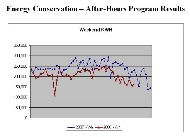

  • Team discussed the need to change the behavior of the production workforce and involve people in energy conservation efforts
  • Discussed the “project as opposed to process” nature of people involvement programs for energy conservation
Initiatives
  • Off-shift and weekend power management program was developed to turn off manufacturing equipment when not required resulting in $150,000 annualized savings
  • Set in place operations and maintenance (O&M) campaign to find and fix compressed air leaks during planned manufacturing maintenance

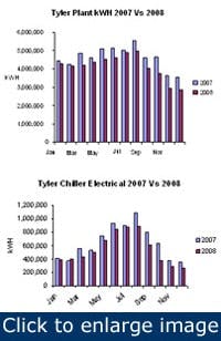

Revised HVAC O&M processes, $180,000 annualized
  • Plant temperature specifications
  • Chiller/cooling tower improvements
  • Raised chilled water supply temperature from 38F to 43F on shift and 49F off shift
  • O&M practices — heat transfer/controls adjustments
  • Added HVAC O&M supervisor on-site

Multiple benefits are being achieved from this program, including improved O&M practices, the use of remote monitoring and engineering support to reduce cost and “hold the gains”, as well as delivering better-than-expected raw cost avoidance of approximately $480,000, including over $100,000 in energy cost avoidance from improved chiller plant and HVAC operation and maintenance.
