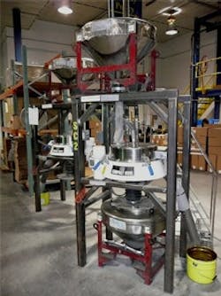

Minton turned to a compact sieve from Russell Finex of Pineville, N.C.. The unit's design and ease of use impressed Minton, who felt it would expedite product changeover and improve bulk powder processing. A trial proved him right, and now there are four compact sieves at the Goshen plant.
"One operator can take apart and put together a compact sieve in less than a minute with no tools," says Minton. "Just undo four latches by hand, lift the top off, and then lift the screen out. To assemble it, reverse the process. It seals perfectly. Because the screen drops into a recess, there's no chance of misalignment; and cleaning is easy with a vacuum line."
"Everything's right there, easily accessible," says Minton. "Pop a cap off the end of the motor and there are your vibration adjustments. It's so easy to do adjustments that one of our junior process engineers realigned it. We showed him once, and he was comfortable enough to make the adjustments himself."
Minton estimates the new sieve technology saves about an hour a day in production downtime, compared to the cumbersome product changeover process required by traditional sieves. Product output and quality are also improved.
