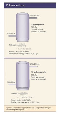

The final guideline originally hatched as a rule of dumb. It has never been correct under any circumstances, yet it has been written about repeatedly, advertised and appears in instruction and training manuals and the Internet. That rule says a two-step capacity control compressor (load/no load) requires 1 gal. of storage per acfm of air delivered if it’s to operate correctly and efficiently.
A two-step or load/no load control also is called full on/full off. It’s a constant-speed capacity control (the motor continues to run) that matches the compressed air supply to the demand. When it senses the cut-in or load pressure, the compressor goes to full flow and stays there until the system reaches cut-out or unload pressure. Then, the inlet valve closes, cutting off flow to the system. The compressor doesn’t reload until system pressure falls to the cut-in or load pressure. The normal operating band usually is 10 psig.
In operation, this control must handle changes in demand while avoiding short-cycling, which is loading and unloading occurring rapidly as the system pressure rises and falls. Short-cycling is hard on the operating components – motor, bearings, drive and cooler – and leads directly to premature failures. Short-cycling on lubricant-cooled rotary compressors often won’t allow the compressor to reach full bleed-down and idle. Such units never reach the lowest possible no-load input kW, which has a negative effect on efficiency. A minimum effective storage controls this phenomenon.
Fifty percent load on a two-step control produces the shortest cycle. Figure 1 shows a 500-cu.-ft. compressor using the 1-gal.-per-cubic-foot rule of dumb and its calculated cycle time – 11 seconds loaded, 11 seconds unloaded, repeating ad infinitum. In the second image it shows the same compressor but with 5,000 gal. of storage (10 gal./cu. ft.) and its calculated cycle time of 110 seconds (1.8 minutes) loaded and then 110 seconds unloaded. In this case, proper storage saved a client more than $6,000 per year (20%).
One gal. of storage capacity per cfm delivered isn’t enough effective storage for two-step control units. At 14.5 psia, it takes approximately an additional 2,800 acfm to pressurize a 400-cu.-ft. receiver from 0 psig to 100 psig. At 11 psia inlet pressure, it takes approximately an additional 3,600 acfm.
Short-cycling is costly. For example, not giving the lubricant-cooled rotary compressor with a 40-second bleed down sufficient time to get to full idle imposes a cost of more than $6,000 per year.
Defining effective storage
When it comes to establishing and using effective storage, most plant professionals avoid mechanical problems by keeping cycle times greater than 1 minute load/1 minute unload. This calls for an effective storage of between 4 gal./acfm and 5 gal./acfm. Be sure you have enough bleed-down time to reach full idle. Check the unit in question. Bleed down time could range from 7 sec. to more than 3 min., depending on size, brand and model. Older units normally have longer bleed-down times.
