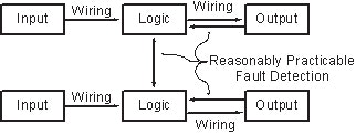

Figure 1. The auditor started by examining possible problems that occur on the output side.
 Let’s say, for example, the risk assessment determined that a specific safety function on the machine must meet Category 3 in accordance with EN954-1 (also published as ISO13849-1:1999). This means the control system’s safety-related parts must perform the safety function in the presence of a single fault. In addition, safety principles must be applied to the control system. The architectural block diagram for Category 3 is shown in Figure 1.
Path of error
The auditor’s checklist for Category 3 might look like this:
  • Do the components meet the requirements of Category B (withstand their expected operating stresses)?
  • Are well-tried safety principles used?
  • Can a single fault lead to the loss of the safety function?
  • Is detection of the fault at or before the next demand of the safety function reasonably practical?
  • Have common mode faults been considered?
  • Have excluded faults been justified?
To conform to Category 3, designers typically use redundant components. But knowledgeable designers and auditors know that simple redundancy might not be sufficient to meet Category 3 requirements. Fault detection at or before the next demand on the safety system often is reasonably practical. The selection and implementation of components that allow monitoring techniques to be applied often accomplishes this.
