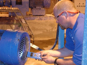

A strobe light was used to provide a stop-action effect on the condition of moving parts. In an Internet search, Hendershott came across the ESL 10-A LED stroboscope by Hoto Instruments (www.hoto-instrument.com). “It was exactly what we needed — small, light and simple to use for on-the-run inspections with LEDs that don’t burn out,” he says. “It’s very easy to read on the run and it comes at a better price than other strobes. And the Hoto LED strobe fits into pouches, which leaves the operators’ hands free.” This is especially useful as operators climb up or down or into various areas to get a look at their assigned machinery.
To accommodate the strobe, belt and rotating shaft guards were modified with cutaways covered in black wire mesh. As operators direct the strobe on the moving parts, the dark mesh provides greater contrast for ease of viewing. This contrast makes, for example, grease stains thrown by loosening bolts more visible.
Pearman says, “The pushbutton speed control on the Hoto LED strobe is just what we needed. By pressing the button, operators can change the flash rate, highlighting different sections of a rotating shaft. Then they can see all sides of a coupling.”
By changing the strobe speed while inspecting a belt, “fraying, bad splices and missing chinks can be discovered before the belts fly apart,” Hendershott says.
Electricians or maintenance personnel provide a more expert opinion, as needed. For example, every 18 degrees of increased motor temperature decreases motor life by 50%. In the motor end bell is a fan that pushes cool air over the motor’s cooling fins. Pearman says, “Greg Vaughn, the mill electrical engineer, and I grabbed strobes to look at the motor end bell cooling systems.” While using the strobes to inspect the cleanliness of the fan blades, Perry and Greg were able find fan blades that were damaged or had broken off, which lead to premature motor failures.
