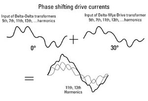

The non-linear currents from two or more three-phase load panels can be phase-shifted from one another through various types of three-phase transformer connections so that their aggregate distortion is less distorted than each of the original’s waveforms. This reduces the distortion of current flowing into the primary power.
In response to the increasing use of adjustable frequency drives in industrial facilities, IEEE 519-1992 has set guidelines for maximum current distortion present at a building service entrance. These guidelines are intended to prevent one factory from affecting the service of another, and to protect utility equipment. The determining factor in meeting IEEE 519-1992 current distortion limits is the percent of the service capacity that is used for serving non-linear loads. Typically, an industrial facility can load up to five percent of its total service capacity with six-pulse variable frequency drives without exceeding recommended limits. Beyond that, some form of harmonic abatement may be necessary.
Motor drive current distortion can be reduced using filters, 12-pulse or higher drives, line reactors, drive isolation transformers or harmonic canceling transformers. Both line reactors and drive isolation transformers use reactive harmonic attenuation effects to reduce the actual current distortion at the input terminals to the drives. This practice alone can increase the six-pulse drive load by 20 percent or more of service capacity without exceeding guideline distortions. The effectiveness of reactive harmonic attenuation varies, depending on other system characteristics. Careful system analysis is always a good idea before applying any harmonic abatement solution to ensure the intended results.
Harmonic abatement using filtering and/or 12-, 18- or 24-pulse drive technology is becoming increasingly popular, but these are relatively expensive solutions. Using transformers for harmonic cancellation can be an attractive alternative, particularly for users who incorporate isolation transformers for their drives anyway. The simplest cancellation method is to provide Delta-Delta connected transformers for some drive power, and Delta-Wye connected transformers for the remaining drives. If the sum of drive loads on each type of drive isolation transformer is balanced, current distortion into the primary system can be reduced significantly.
The largest distortion components by far in six-pulse drive current are 5th and 7th harmonics. Eliminating these can significantly improve point of common-coupling current waveform distortion. The 5th and 7th harmonic cancellation effects brought about by the 30-degree phase shift between Delta-Delta and Delta-Wye connected transformers will depend on load balance. For continuous torque applications, where loads are fairly constant, close load balance is easier to achieve. On the other hand, process control applications, such as punching, stamping or motion control, make it difficult to maintain consistent balance of multiple drive loads at any given time.
In some cases, Delta-Delta connected drive isolation transformers are undesirable because the secondary cannot be grounded in a balanced way. Ungrounded power can adversely affect the operation of some drives, and can cause drives to trip on surges and impulses coupled from the primary service. For these applications, Delta-ZigZag connected transformers are available. This zero-phase shift connection acts like a Wye source for the drive, providing a balanced neutral point for grounding. At the same time, they substitute for Delta-Delta transformers, providing the same harmonic abatement when used in combination with Delta-Wye connected transformers serving other drive loads on the same service, as in Figure 4. Of course, when voltage change is not required, the use of line reactors on half the load along with Delta-Wye connected loads on the other half also can be used.
