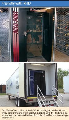

8. Automate materials management
Robert Holmes, marketing director for WinWare (www.cribmaster.com) says, it can take 30 minutes at large facility to get a tool or supplies, between shutting down the machine, traveling to the crib, waiting for the item, returning to the equipment and starting it up. The advent of RFID changed all that. Now companies can place high-use items at the point of use in a secured environment, and allow automated checkouts and returns.
"When you walk through CribMaster’s Accu-Port portal system, your RFID badge is authenticated automatically. As you walk out, the system automatically tracks the materials you take," Holmes explains. "All management decisions (e.g. when to order, move or calibrate) occur electronically." Supplementing the primary tool crib with point-of-use RFID technology can shrink its physical size and the amount of inventory it contains. In addition, automating reorders reduces the cost to cut purchase orders.
“Materials management can improve workforce efficiency — or disrupt it,” Kronenwetter says. “To maximize efficiency, make electronic connections to suppliers where possible. Integrate the vendor into the workflow so parts and materials orders are generated automatically. Also, ask to receive parts pre-kitted for PMs.”
Crown Equipment (www.crown.com) chose Accu-Port to provide its employees 24-hour, unmanned access to tools and supplies. They tagged reusable packaging rather than the products to save on tags and simplify restocking. Labor costs were reduced because a 24-hour position was replaced with a 90-minute, light-duty restocking role. Walk time and downtime were reduced, productivity improved and better purchasing information led to an $83,583 reduction in annual inventory usage.
Job Site Resources is leveraging CribMaster technology in its turnaround trailers. With proper authentication, contractors can rent tools from within an unmanned truck trailer. The system provides accountability for the materials and controls returns to reduce lost tool costs. Additionally, it shows maintenance personnel which tools were used so that unnecessary refurbishments can be avoided.
