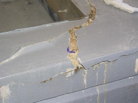

1660329332098 Fig2 Perf Floor

Balancing the right pH and the right moisture level in slabs can be a challenging and often costly problem. Concrete has a naturally high pH. But, many flooring manufacturers won’t warranty installations if the pH is at those naturally high levels, even though moisture is low (Figure 2). Nationwide, moisture and pH-related flooring problems have reached the billion-dollar level annually, according to independent concrete flooring expert Scott M. Tarr, principal engineer at CTL Group, Skokie, Ill. Some factors driving these problems include:
Figure 2. Coatings failure and pH irregularity caused cracks in this floor.
