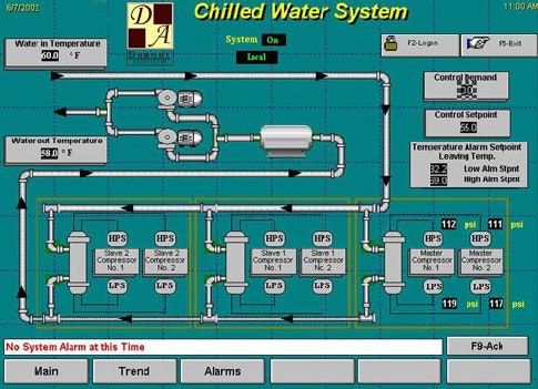

The basic parts required for Web-based data acquisition and control are:
  • An interface to the machine or process to be monitored or controlled via the Web (network)    connection.
  • A Web server to make the desired display and control pages available to the remote browser or    client.
  • A data service or interface to handle exchanging data between the local machine or process    (server) and the remote system (client).
The only requirement for viewing data and Web pages remotely is a standard browser interface. Applications featuring statistical process control, optimization or enterprise level software to exchange real time data with the machine/process require a remote server PC and a compatible data exchange service. Figure 2 shows a simplified block diagram for the parts.

Figure 2: Block diagram of PLC, Web server and network
