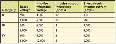

The international standard for test equipment safety is IEC 61010-1 (formerly IEC 1010-1). Table 1 shows the four measurement categories, sometimes called installation or location categories, the standard defines, as well as typical locations within a plant that fall under each category. The categories are based on the length of the conductors from the electrical service connection.
Higher measurement categories apply to testing performed closer to the point of origin, where a voltage impulse delivers greater energy to connected meters. Therefore, a meter rated for a higher category features larger electrical clearances and creepage distances to withstand these impulses (see Table 2). At lower category locations, the facility wiring tends to attenuate impulses, and meter construction requirements are less demanding. When in doubt about a location, assume it falls under the higher category.

Meters also should be marked with a safety category rating, which consists of a rated voltage and a measurement category, such as "600V CAT II." This marking specifies the maximum voltage that can be applied to the instrument for any type of measurement when it's connected in the category location. The latest IEC standard requires a meter to be capable of being set to any function or range with the leads connected to the maximum rated voltage without creating a hazard. Equipment can be dual-rated, for example 1000V CAT II / 600V CAT III. If a meter doesn't have a marked category rating, it's a CAT I device.
Often the rated voltage is lower than the meter's measurement range. Figure 2 shows two meters with the same measurement range of 750 VAC or 1,000 VDC. The lower meter is rated for CAT III over its full range. The top one, however, is limited to 300 V in a CAT III location, and can be used on higher voltage only in a CAT II location.
Select a meter with a safety rating that exceeds the anticipated application requirements for both the category and voltage. For most industrial work, 600V CAT III will be the minimum acceptable. The latest models from several manufacturers have ratings of 1,000V CAT III / 600V CAT IV. Don't forget that these ratings also apply to test leads, clamp-on adapters and any other electrical accessories. The lowest rating on any of these determines the limit for the measurement.
