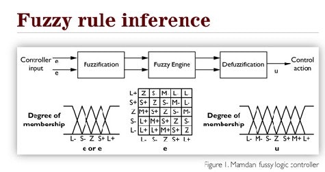

In the early to mid 1970's, Mamdani investigated the fuzzy logic control as an alternative to the PID controller. He designed a controller that followed rules rather than a numerical formula. His rules were analogous to PI control. As a result, rules generated an output by evaluating error and change in error. For a reverse acting control loop, a large positive error calls for a large negative output change, while a small positive error calls for a small negative output change. Similarly, large change in error calls for large change in direction of the output, while a small change in error calls for a small change in direction. When there is no error or change in error, there is no change in output. This is an excellent application of fuzzy logic control because it's easily generalized to almost any process.
The rules can be represented in a truth table (see Sidebar). Note the symmetry of the outputs for these rules. The next issue is to define what constitutes a large error and large output. Membership functions are created for error, change-in-error and change-in-output. Mamdani defined five to seven membership functions for each variable. They were triangular in shape, symmetrical, evenly spaced and overlapping. Some experimentation was done with different numbers and shapes of membership functions, but the increase in complexity was not adequately rewarded by a performance improvement. However, the size and overlap of membership functions are tunable parameters analogous to conventional proportional, integral and derivative gains. Judicious selection of these fuzzy tuning parameters results in more or less aggressive control for a given process.

Fuzzy theory
Fuzzy logic is executed in three steps. Fuzzification uses membership functions to transform analog variables into fuzzy variables. Membership functions can take on different shapes, but triangles are most common. The degree of membership varies from 0 to 100 percent as represented by the membership functions. In the Mamdani controller shown in Figure 1, membership functions for error and change-in-error have values of positive large, positive small, zero, negative small and negative large.
Looking at the membership function for zero, we see that the absolute value of zero is a member of the fuzzy variable zero with a degree of membership of 100 percent. As the actual value moves away from zero, the equivalent fuzzy variable is zero with a decreasing degree of membership. Finally, at some distance from zero, the real variable is no longer a member of the fuzzy variable zero. The overlap between membership functions means that some value of the real variable error (or change-in-error) is actually a member of two different fuzzy variables.
The fuzzy engine contains the rules to be executed. The rule array is analogous to a truth table with fuzzy error variables in one dimension and fuzzy change-in-error variables in the other. We can see that for this fuzzy engine, a large positive error and a large positive change-in-error requires a large negative change-in-output. This is consistent with a reverse acting feedback controller. We also can see that when the error is zero and the change-in-error is zero, there should be no change-in-output. Again, this is reasonable behavior. Examination of other rules leads to a similar conclusion. Each rule with true inputs generates an output proportional to the input degree of membership.
Because more than one output is likely to be true, defuzzification transforms them into a crisp value. Defuzzification is the inverse of fuzzification and uses membership functions as well. In this example, there are two additional membership functions (negative medium change-in-output and positive medium change-in-output), but they have the familiar triangular shape. The output is determined by calculating the "center of mass" of the membership functions that are true as a result of the fuzzy engine.
Because the controller must be matched to the process dynamics, we must have some tunable parameters equivalent to proportional, integral and derivative gains. The range of the membership functions can be adjusted to achieve the desired control performance.
