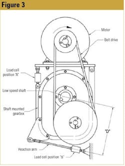

Depending on location, load cells can give fairly accurate indications of the load spectrum, including shocks. Figure 3 shows a shaft-mounted gearbox with two possible positions for load cells. A tension-compression load cell in position A supports some of the motor weight while reacting to the drive belt force. A tension-compression load cell in position B reacts to the torque on the reducer’s low speed shaft. Position B is much better.
In position A, the drive’s mass and the elasticity and friction of the V-belt damp out shocks. In position B, the mass of the entire drive dampens some shocks, but because the gearbox case is so closely coupled to the shock source (the low speed shaft), a load cell provides fairly good indications.
In the drive depicted in Figure 3, the load cell in position A gives much higher readings for clockwise belt drive rotation than for counterclockwise. With clockwise rotation, the load cell is much closer to the belt’s taut span. For counterclockwise rotation, it’s better to have the load cell on the right instead of the left.

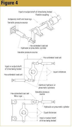

Calibrate sensors before recording data. A typical calibration procedure mechanically locks either the input shaft or the output shaft and applies known loads to the other end of the drive while recording readings for each applied load. It’s important that sensors and drive train components experience the loads in the same manner as when the drive train is operating. This can be awkward in the case of loads that are purely torque. For example, if the gearbox output shaft is coupled to its load with a gear coupling, the load is pure torque. If the sensors are calibrated by applying known loads to the output shaft, the applied calibration loads also should be pure torque. Figure 4 shows three schemes for applying pure torque loads. Keep in mind that the locked drive also applies a load, so the locking method also must represent operational loads accurately.
