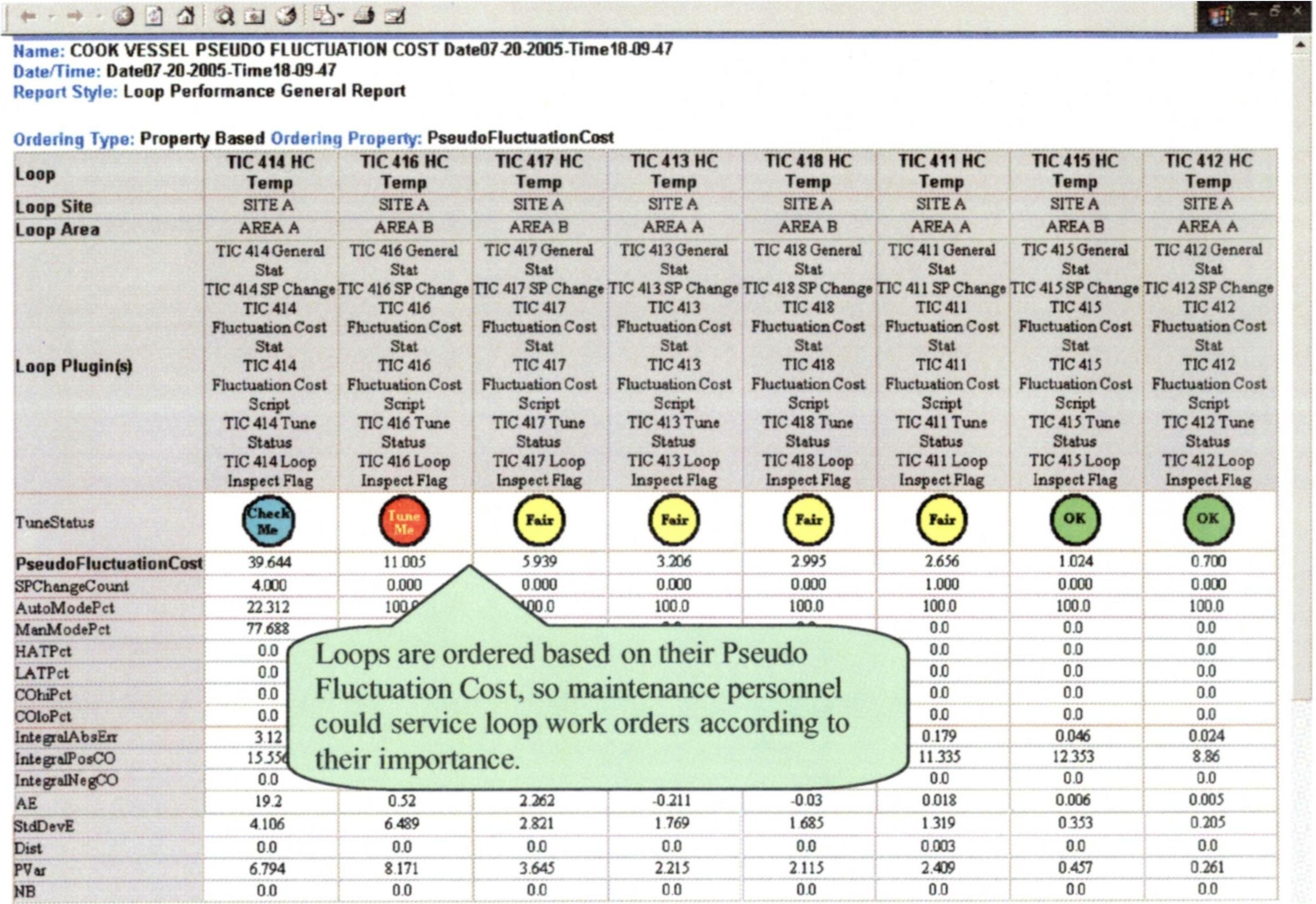

Pseudo fluctuation cost model (PFCM)
An alternative method that’s rather easily implemented on a large scale is based on only three steps: Developing a PFCM for the controllers, categorizing the loops based on their type and independently prioritizing the maintenance for controllers belonging to each type. As an example, consider the following model that provides a pseudo fluctuation cost per one unit of time:
Pseudo fluctuation cost = (IAE * value of processed product)/T (Eqn 2)
The principle behind this approach is that the cost associated with a poorly-performing controller used in producing a valuable product is likely to be higher, and thus its maintenance should be given precedence.
In Equation 2, T denotes the length of time during which the integral absolute error and the value of the processed product are evaluated. The value of T for a batch process could be the batch time and for a continuous process could be four times the dominant time constant. The integral absolute error captures the amount of fluctuation calculated using percent setpoint error and the value of the product processed during interval T. Figure 3 depicts an implementation of this method.
Rating by loss
Figure 3. Proritizing loop maintenance using pseudo fluctuation cost. Click on image for larger version.
