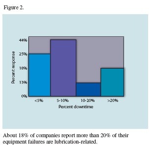

What percentage of your equipment downtime is related to lubrication? More than 18% of companies report that more than 20% of their equipment failures are directly related to lubrication problems (Figure 2). The first step in solving a problem is knowing you have a problem, and the next step is knowing how large the problem is.
Companies tell me they don’t have money to improve anything. If their total annual sales are $60 million, total downtime is 10% and 25% of downtime is due to improper lubrication, the lost opportunity cost due to lubrication is $1.5 million. With numbers like these, the money is there – it’s just that no one in the operation knows it or can measure the losses.In what area do you have the most lubrication problems?  In a reactive environment, we do not focus on the real problems but on the problems that face us on a specific day. I used to work in that type of environment, but later transitioned to a very proactive environment. Based on my experience as a maintenance practitioner, I thought motors and gear reducers would be the biggest problems.But as one can see (Figure 3), respondents say bearings are the largest problem in most organizations, with gear reducers a distant second. Only about 3% report motors as the biggest problem. It could be the motor rewind shops are not telling us the whole story -- I visited a large motor rewind facility and was shown numerous motors that had failed as a result of either lubrication bypassing a sealed bearing or being pushed through the bearing and into the motor windings.
