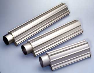

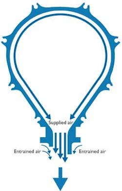

Using a compressor or blower as the air source, an air knife converts a low-pressure volume of air into a high-velocity, targeted stream of high-impact air, which exits the knife from a long thin slot. Air knives are designed in a variety of shapes and sizes, with a teardrop shape providing the most efficient airflow. In this configuration, the air stream attaches itself to the curved internal surface of the knife and entrains ambient air when it exits the slot (see Figure 1). Entrainment increases the total volume of air hitting the part's surface. Other shapes include a round and diamond tube, but flow efficiency through these designs is lower. The size of the parts being processed determines knife length. A variety of slot sizes allows for variability in the volume of air delivered (see Figure 2).
Free air
Figure 1. Air entrainment adds muscle to the blowoff.

Figure 2. Air knives in various lengths and slot widths.
