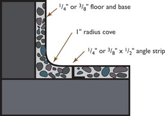

In most cases, dividing strips are used during the installation of terrazzo (see Figure 1). They enhance and highlight color patterns. Available in zinc alloy, brass, black and white or colored plastic, divider strips complement the terrazzo floor. They may be specified in custom sizes, shapes and even intricate configurations to produce beautiful and unusual designs, color effects and corporate logos. Used not only to enhance or highlight color patterns, the divider strips also serve as a control for anticipated contraction, a leveling device and a crack preventer.
Divide and control
Figure 1. Divider strips can beautify floors as well as provide contraction, level and crack control.
