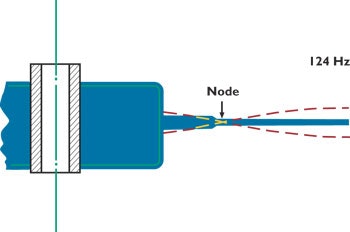

A large sintering plant had a 98-inch diameter axial flow impeller with several cracked blades. In fact, one blade tore completely loose from the hub. A vibration analysis revealed three natural frequencies or modes:
At 92 Hz, the blade vibrated as a cantilever with its base anchored and the entire blade flexing up and down (see Figure 1).
At 124 Hz, the blade exhibited one node near the transition point between the thicker and thinner sections of the blade (see Figure 2).
At 372 Hz, the blade exhibited a node at the base of the blade and another just beyond the transition point between the thicker and thinner sections (see Figure 3).
Figure 1
Figure 2
Figure 3
The 10-bladed impeller operates between 680 rpm and 750 rpm, which produces a blade passage frequency between 113 Hz and 125 Hz. The blade passage frequencyits operationally induced frequencycoincided with the second resonant frequency. As a result, the blades developed cracks at the node location. A redesigned blade featuring a beefier cross section raised the resonant frequency to 152 Hz, which solved the problem.
