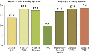

In a study of more than 25,000 roofing systems in use between 1975 and 1996, Schneider and Keenan1 calculated the average service life for a variety of roofing styles (see Figure 1).
Average service life in years
Figure 1. Major categories of low-slope commercial roofing systems performed in a fairly narrow range, according to a study of more than 25,000 roofing systems in use between 1975 and 1996.The study found that the useful lives of major classes of low-slope commercial roofing systems cluster in a fairly narrow range. Most systems lasted between 16.8 and 18.4 years, with the exception of asphalt BUR (13.6 years) and PVC systems (9.5 years). However, Schneider and Keenan observed that premature failures of two-ply systems installed in the early 1970s might have shortened the average service life of asphalt BUR. Also, the high number of premature failures of unreinforced PVC membranes installed in the mid-to-late 1970s noticeably affected the average PVC service life.Because manufacturers no longer sell these products, most roofing systems installed today should provide close to 20 years of useful working life, assuming that the roofing system is installed by a trained, experienced roofing professional.Maintenance adds years to service lifeProper maintenance can extend the life of some roofing systems beyond 20 years. In fact, 30-year warranties are now available for single-ply EPDM roofing systems as these systems have a proven track record of long-term success.Although Schneider and Keenan didn't examine the effects of maintenance, it's believed that roofs with longer-than-average service lives received professional maintenance regularly. Accordingly, the cost of maintenance must be included in any life cycle cost calculation. However, this cost may be offset by an increased overall service life.It's also possible that the differences in service life mirror the ease of maintenance for different roof systems. For example, the gravel surfacing of asphalt BURs can complicate locating and repairing minor flaws, which accounts for the relatively low average service life that Schneider and Keenan discovered for these systems. On the other hand, the relative ease of inspecting and repairing a more-accessible membrane surface explains the longer average service life for modified bitumen and EPDM roofing systems.Many owners and managers also recognize that new roofing products can minimize annual maintenance expenses. Increased interest in more durable roofing systems may be driven by concerns about weather-related rooftop damage and more realistic expectations of the effect of service traffic on roofs.For example, 90-mil EPDM roofing systems offer more resilient thickness and protect against natural weathering and service traffic for the periodic maintenance of rooftop equipment. When assembled with polyiso insulation that is factory-applied to strand board, these roofing systems can protect against incidental punctures, 100-mph winds and two-inch hailstones. In addition to extended service life, this type of roofing system can offer a lower annualized cost than 45- and 60-mil EPDM, two-ply modified bitumen, four-ply BUR, and 45- and 80-mil TPO membranes.Avoid overestimating your investment horizon
