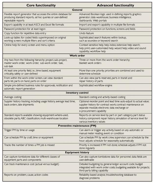

Core features and functions
Contrary to popular wisdom, small maintenance operations are just as keen to purchase high-quality software as are large maintenance shops. Attributes, such as fast response time, high reliability, ease of navigation and consistent screen design, are just as critical for a small plant as they are for a large one. It's the quantity and complexity of functionsnot qualitythat varies across the company size spectrum.
Regardless of the size of your company, expect certain core features and functions no matter what the cost or market focus of the CMMS package. Generally, as company size increases, in certain niche markets and in light of specific business requirements, the demand for more advanced functionality increases.
