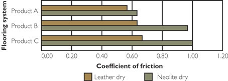

Wen-Ruey Chang and Associates at the Liberty Mutual Research Center for Safety and Health have studied the role of surface roughness in floors and footwear. They concluded that the combination of the microscopic roughness of the sole and the floor surface affect the coefficient of friction significantly. This principle helps to explain the extreme variances obtained when various waxes and sealers are used on textured floors. It's important to ensure that ADA-compliant sealers and maintenance materials are used in lobbies and restrooms, where a noticeable, macroscopic surface texture is absent.
In our research, the ASM 725 Slip Meter (American Slip Meter, Inc.) was used to measure the static COF of various dry industrial flooring systems with smooth and textured surfaces. The meter determines the force necessary to initiate movement of a weight. Two different grades of aggregate were used, a 40/60 mesh silica sand and a more aggressive 30 mesh silica sand. Results indicated that a smooth surface complies with ADA 0.5 COF recommendations in dry conditions, but the addition of texture to the flooring system dramatically increased the COF for both leather and Neolite (rubber) soles. The 30-mesh aggregate improved slip resistance as represented by an increased COF (see Figure 1).
Figure 1. Effect of texture and footwear on coefficient of friction in dry conditions.
When these tests were duplicated under oily conditions, the smooth surface's performance was below the "safe" recommendations while both textured surfaces exhibited an increase in coefficient of friction. It must be noted that, although these tests provide relative performance for a valid comparison, the static measurement of slip resistance may not fully reflect the degree of "slipperiness" of an individual's walking dynamics. While water and oil exhibit a cohesive force with stationary objects, once moving, the force required to maintain movement is significantly less (see Figure 2).

Aluminum oxide provides a non-slip surface in areas subject to the most extreme conditions. Its angular shape yields a high coefficient of friction. Figure 3 illustrates that Neolite (rubber) footwear tends to provide a higher coefficient of friction than leather at every level of flooring system texture. As Figure 4 shows, in dry, wet and oily conditions, the flooring under test maintained a high level of slip resistance. When an epoxy topcoat was applied over the aluminum oxide, the coefficient of friction decreased.
